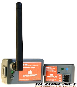

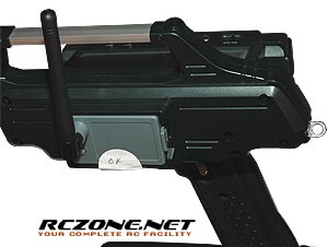

OdgovorNapisal/-a lagnaf » 17.12.2004, 10:25
Deluje na frekvenci 2.4GHz.
Deluje po sistemu plug and play. Nič kvarcev! Čez 4 bilijone zaščitnih kod.
Uporabno za modele:
Airtronics- M-8
JR- R1
Futaba- 3PK
HiTec- Aggressor CRX
KO- Helios
Ker dela na tako visoki frekvenci praktično nima nobenih motenj od drugih sprejemnikov in motorjev na nižjih frekvencah (27 - 75mhz).

DSM System Specifications
• Frequency Band 2.400-2.4835 GHz
• Channels 79
• Channel Spacing 1 MHz
• DSSS Coding Gain 18 dB
• Bitrate 15.626 kbps
• Range 3000 ft
• Latency 7.4 Ms
• Resolution/Channel 4096 steps
DSM Transceiver Specifications
• Weight .40 oz/11.3g
• Dimensions (LxWxH) 1.62x1.06x.57in (41.2x27.0x15.3mm)
• Input Voltage 3.2 – 9.6V
• Sensitivity -98 dBm BER 1E-3
• RC Channels 3
• Current 40 mA @ 4.8V
• Antenna length 8.5 in
ETAs and Pricing
Airtronics Early January
Ko Propo January
JR Late January
Futaba/Hitec February
3-Channel Surface System (include transmitter module & receiver) - $159.99
Additional 3-Channel receivers - $79.99
Link: http://www.spektrumrc.com/
Link: http://www.horizonhobby.com/Shop/ByCate ... ID=SPM1004
