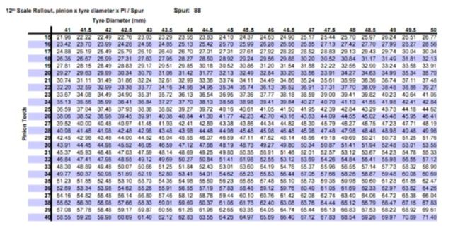

za vse tiste, ki še ne znajo izračunat prenosa.
Tire diameter X 3.14 *tire diameter->rear tire
spur : pinion
priporočam, da si nardite tabelo za zobnicke, ki jih imate doma na voljo.

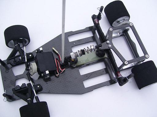

OdgovorNapisal/-a DMX » 16.03.2009, 23:30
še Full Throttle Motorsport FTR-12th Scale

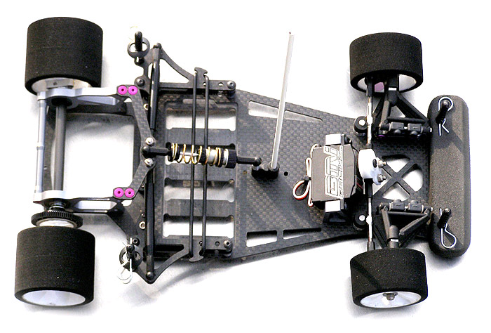

OdgovorNapisal/-a DMX » 23.06.2009, 19:55
novost pri BMI je DB12RR Lipo Edition!
http://www.bmiracing.com/bmiv4/
As the use of LiPo batteries in the 1/12th scale class has been gaining ground and sanctioning bodies and manufacturers have begun standardizing cell formats, BMI Racing have finally developed a new version of the DB12RR for this class. The LiPo edition features a lower chassis that has been optimized to locate and retain a 4000mah 3.7v LiPo pack. The chassis has had the slot dimensions adjusted to match the pack as well as pocketing of the chassis to lower the pack for optimum center of gravity.
