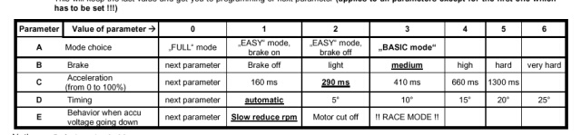

poglej si malo navodila na
http://www.mgm-compro.cz/en/
(download/manuals)
Bremza je v vseh primerih on/off , nastavljaš le "trdoto". Torej če bi bilo bila pogojno uporabna samo lahka "light".

Res škoda, da gospod Dvorsky (MGM) še ni dal ven reglerja s CAR sotwareom. Nekaj se je govorilo že spomladi...

for controller: i was afraid that the controller could be damaged because its only a 40A-controller..
but.. it seems to work.. gets only 38°C warm... (thats about human body-temerature.. can´t say how much °F that is..)
was first batt with that car...
first batt with that motor
first batt with a pistol-grip-rc for me.. and well.. it works very very fine !
also the programming..
the controller has very very hard brakes.. so i limited it through transmitter to 55% works great now..
also cool: you can limit the steering in relation to the gas-throttle -possition..
