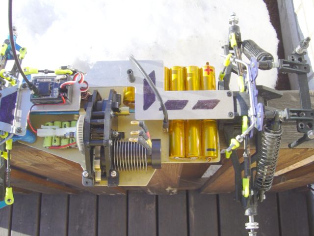

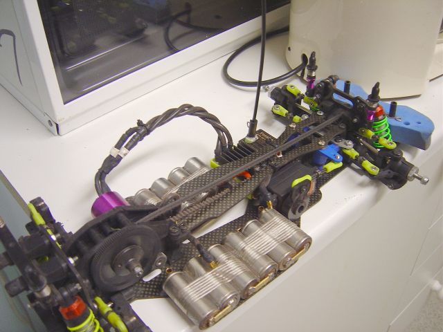

Kolega NIC iz Švedske je poslal naslednje slike svojih modelov.
Here are one on my TF-2 with U-Force.

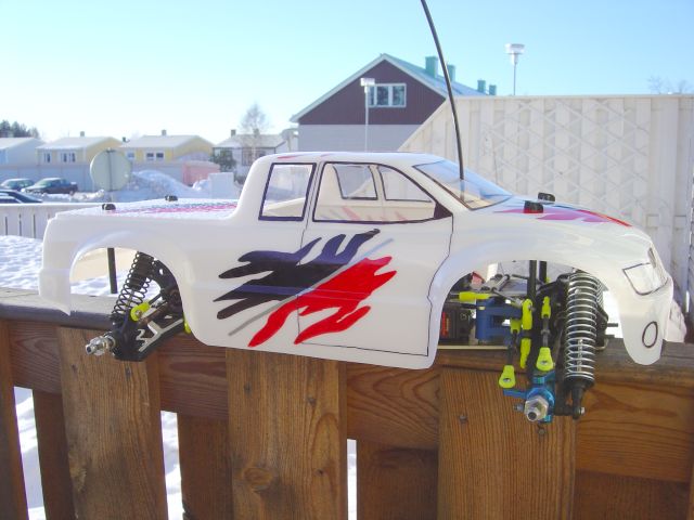

OdgovorNapisal/-a mihah » 25.02.2004, 11:29
Homemade monstertruck: I used a TF-2 rear end as a centraldiff ! Giving me a possible gearratio of 12:1 to 64,5:1 ! It has a slipper also, and 1/8 buggy springs with a 3 mm rear stabilizer and 2,5 mm at the front. Corners like you woulden´t imageing ! 9 cells and the C40 6L.
With Mad Force body on:
