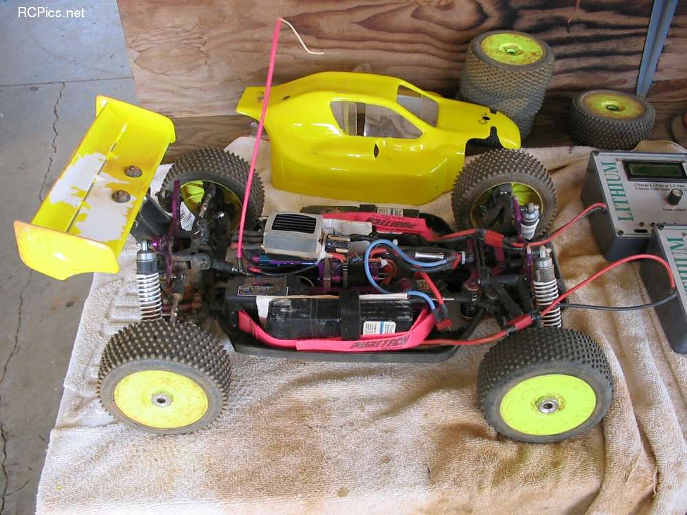

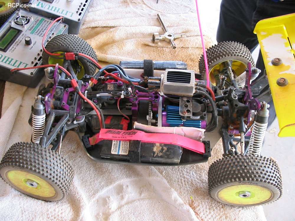

My extremely modified thunder tiger bike. I think there is like 20% of the original parts left. Carbon and delrin everywhere. I have a futaba digital servo to throw the front disc brake. Screaming fast!!
OdgovorNapisal/-a mihah » 21.03.2004, 17:16
LiPO BK 1/8 buggy.
