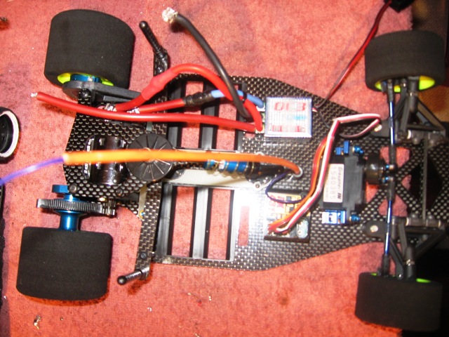

OdgovorNapisal/-a asso » 02.01.2008, 21:39
evo puščice
112 001.jpg (124.1 KiB) Videno 36248 krat

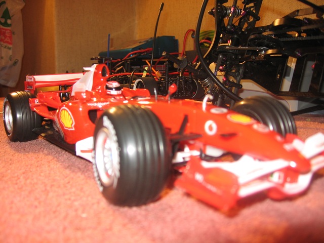

by lojz
112 004.jpg (107.81 KiB) Videno 36222 krat

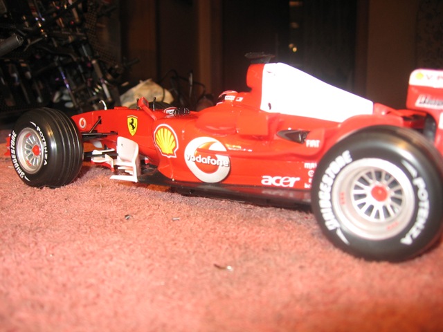

pa še 1:12 malo drugače, drugače tudi vozen
112 005.jpg (91.56 KiB) Videno 36170 krat

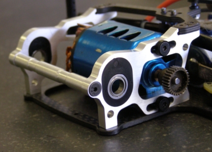

OdgovorNapisal/-a Lojz » 06.02.2008, 21:05

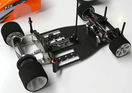

Serpent bo predstavil svoj 1/12 model.
Serpent S120
Serpent’s first entry into the resurgent 1/12th scale 2wd pan car class, the S120 sports a one piece CNC machined aluminium rear pod, central main-shock combined with S120 lateral monoshock. Other innovations include a centrally mounted tweak adjuster as well as adjustable front suspension with independent upper a-arms and pivot ball mounted steering blocks. High quality carbon fibre and glass fibre components are used throughout as well as machined aluminium parts.
LP, Lojz
Serpents 120hr.JPG (29.37 KiB) Videno 35753 krat

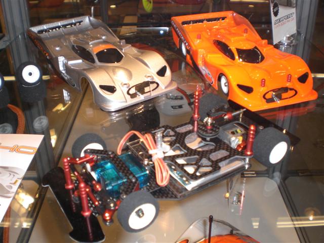

OdgovorNapisal/-a dušan » 10.02.2008, 15:13
Tako nekako pa Serpent zgleda v živo.
CIMG0090 (Small).JPG (63.33 KiB) Videno 35586 krat

OdgovorNapisal/-a Lojz » 10.02.2008, 15:30
Tole je Serpent S240 1/24 z LiPo celicami. S120 1/12 slik še nisem videl.
LP, Lojz

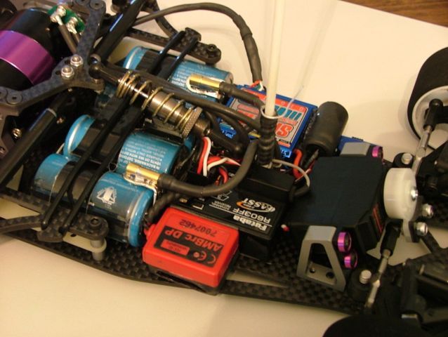

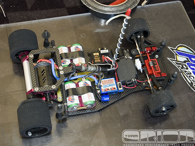

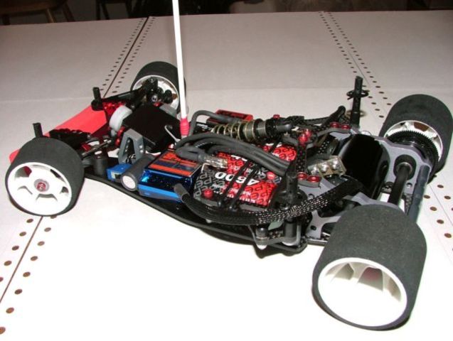

OdgovorNapisal/-a DMX » 27.10.2008, 18:11

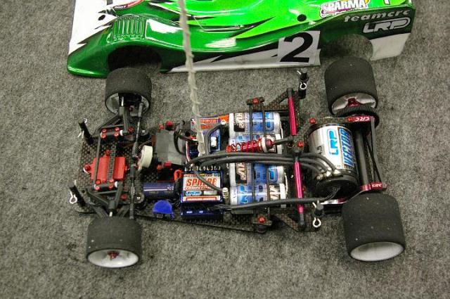

eden najboljših modelov BMI DB12
mogel sem ga prilimat gor.
dost je blo :ymsmug: :-t
bmi r.jpg (59.11 KiB) Videno 34875 krat
bmi rb.jpg (44.2 KiB) Videno 34876 krat

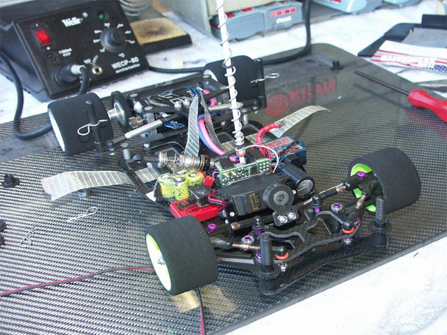

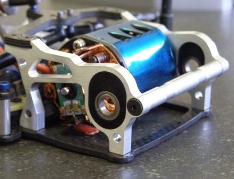

izboljšava ki naj bi prinesla največ na modelu
new pod 1.jpg (96.14 KiB) Videno 34870 krat

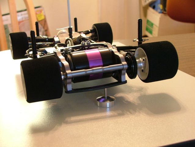

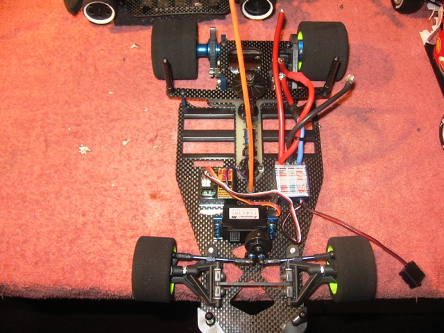

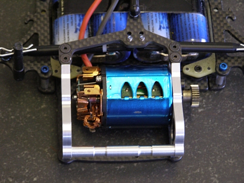

z drugega zornega kota

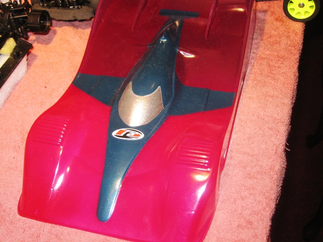

še s pričje,...
