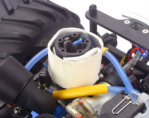

After the engine is running, it is important to keep the temperature of the engine up around 200 to 215 degrees during break-in. In weather below 45 degrees, the TRX2.5 engine will not want to run over 160 to 180 degrees (when tuned at proper break-in mixture settings). This is too cool for break-in.Do not lean the engine to get a hotter temperature. This will decrease lubrication as well, and will also cause your piston/sleeve to wear prematurely. :?
You can wrap the cooling head with a paper towel, clean rag or sock to help keep the engine running around the recommended 200 to 215 break-in temp. Be careful, if too much heat is contained, the engine can actually run too hot. Make sure that you monitor the engine's temp closely for the first couple of tanks until you get the right amount of cover for the cooling head. This will, of course, depend on your current weather conditions. Adjusting the cover up and down, exposing more or less cooling fins, is a convenient way to regulate engine temps.
You can also run an uncut body on the vehicle to block the airflow across the engine to help keep the engine temperature where it needs to be.
For owners that do not have access to a temperature probe, a drop of water on the cooling head (around the glow plug area) should slowly sizzle for approx. 6 to 8 seconds around 200 to 210 degrees. If the water sizzles for only a few seconds, then it is likely that it is over 220 degrees, and needs to cool down. If the water takes a long time or does not evaporate at all, then of course, it's too cool.
